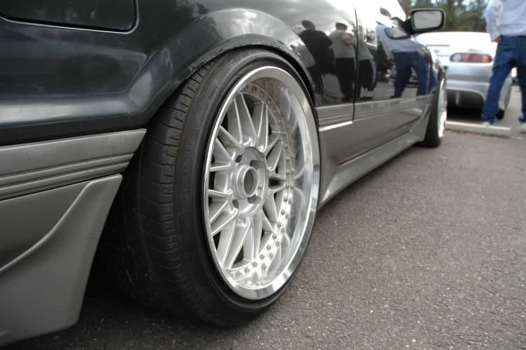

    blake...
    i used those exact tools to pump the guards on my soarer
    like so
    Project Soarer II - Sold

    well you roll the lip up by using the main meat of the roller first and then you start applying more pressure using a smaller amount of the roller on the edge of the guard, the more pressure and less surface area of the roller you use the more of a lip you will get...
    I used a fair bit of pressure and more of the surface area...that way it "pumps" the guard as opposed to lippping it...giving it a ghey verandah affect...which is easier but is harder to get flush fitment with
