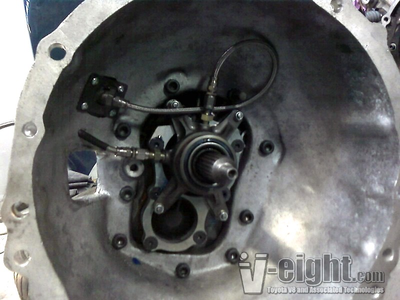

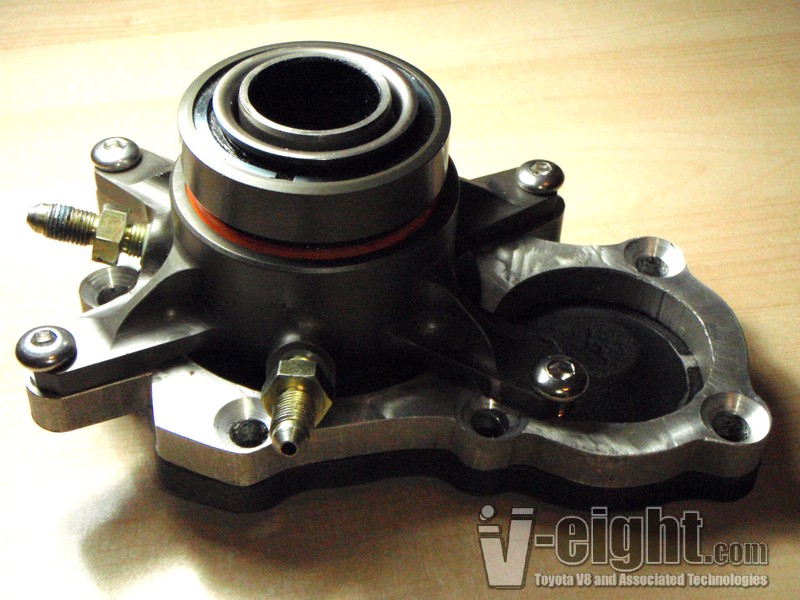

    Easiest way would be to use something like this:
    That's for a W58, not R154 like the Thor one. Maybe ask Ed_jza80 how much to make one for you.
    Or you could punch a hole in the side or the auto bellhousing, carefully machine in a spot for the clutch fork pivot ball and machine in a spot to mount the slave cylinder. Probably quite a few hunj just in machining costs.
    Good idea buying that cheap adaptor ring.

    Ed will sell you the adapter plate cad file for $20
    http://www.v-eight.com/tech_forum/vi...php?f=40&t=630
    Tilton throwout isnt that much, i have heard $100 bandied around.
    1,811
    Default Re: how to make 1uz a manual
    There you go....couple hundred bucks...problem sorted.

    the thor version already has the throwout bearing pattern drilled into it (from looking at 5kgt's one)
