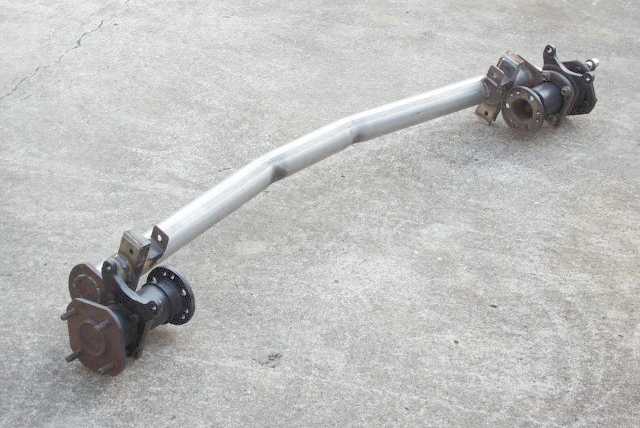

    Info on Engine & Tyres ?? 3UZ? from your other thread?
    A small but hypo engine isn't going to produce masses of torque and if you can't fit big meats then they aren't going to have masses of grip !?!?!
    You could always develop a de-dion rear end using a *A70 G-series, keeps the unsprung weight down, you could retain the 4-link +panhard (or Watts) and build some rear camber into it.
    From here
