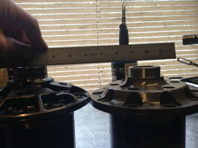

    Looks like I have an issue with the diff
    I ordered a Cusco LSD for it. First issue is, when the diff place took mine apart, says one tooth is broken from the crown wheel. He says it doesnt look like wear, but more like something has hit it....second, he says the Centre I ordered Cusco 1.5Way LSD 167 L15
    http://www.cusco.co.jp/products/pdf/P182-191.pdf is 10mm too short! Any input from you guys?? From the site, it says it suits NA 6 Speed and 6 speed from 96 up (Mines a late 96)
    Looks like I might need to source a new diff also
    My Car original came with the A03B. I swapped it for an A02B (For the shorter ratios)

    I think this may confirm that the LSD is for a B not A series and Cuscos website is incorrect with the part numbers?
    Check this
    Cusco:
    Stock on left Cusco right
