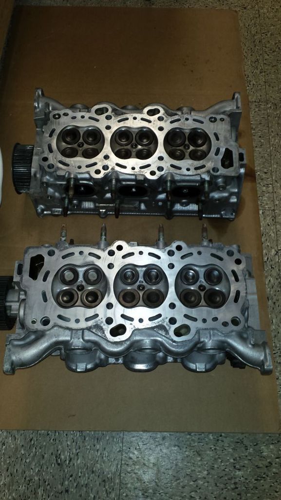

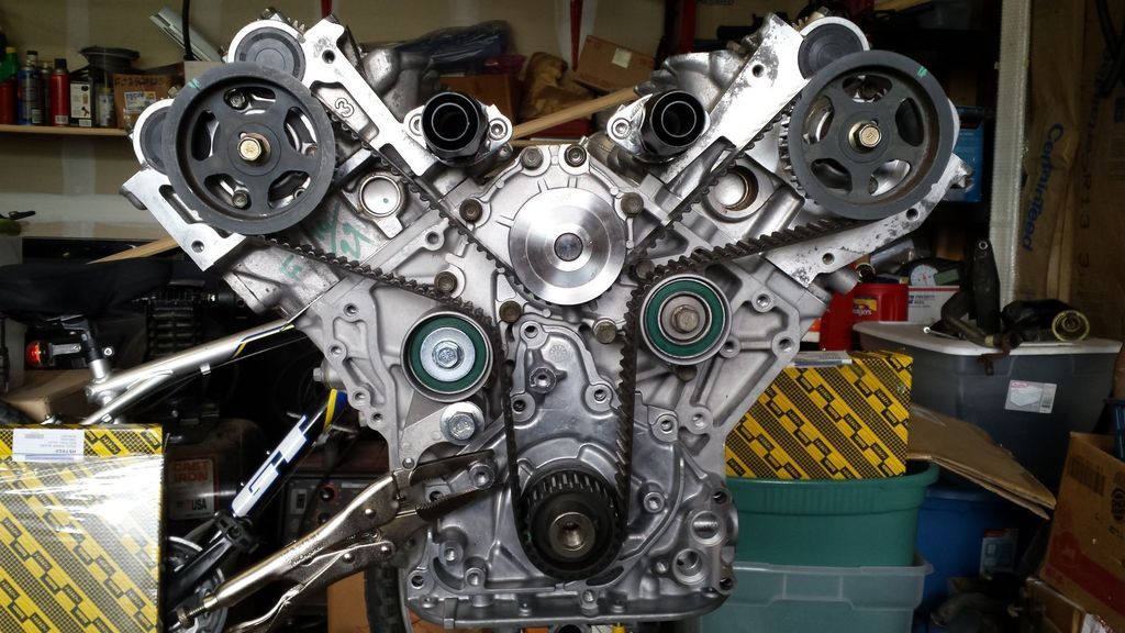

    I’ve been thinking are there any light weight NA V6 engines out there that people are overlooking for transplants into 70’s RWD’s? Is there a better option? Is there something worth taking a punt on? I believe there is. The all-aluminium, Honda cast, Isuzu designed quad cam 3.2 and 3.5L V6 (6VD1 and 6VE1 respectively.)
    This lump of forgotten metal came in virtually every petrol Holden Rodeo between 1996 and 2004 with updates in 2000 (tall deck, minor head revisions) and 2002 (3.5L.) It’s a bit of an oddball with its 75o Bank angle, but who cares, it’s setup for even firings.

      Boost friendly 9:1 compression (but yeah, pretty mild for an NA Engine.)
      Large and well-designed intake and exhaust ports.

    1: while doing an inspection yesterday found out the engines are rear sumped, steering draglink could possibly be in the way. Old 70's steering box Toyota's have this draglink just in front of the bellhousing. This is where the sump is.
    2: Overall height may be an issue. While the engine is compact, the stock inlet manifold sits quite tall.
